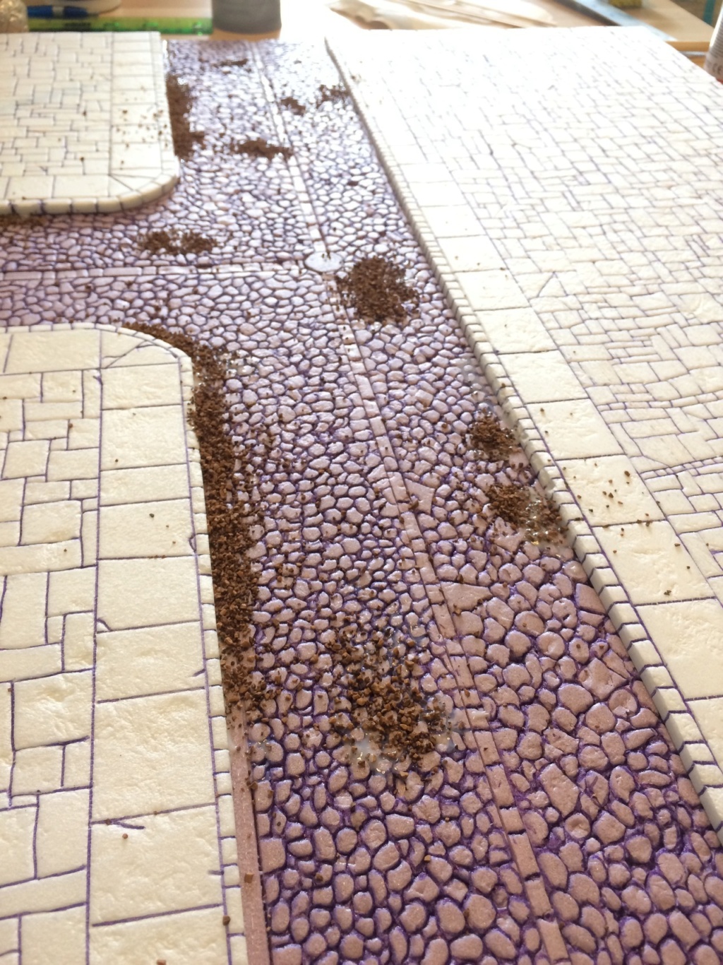

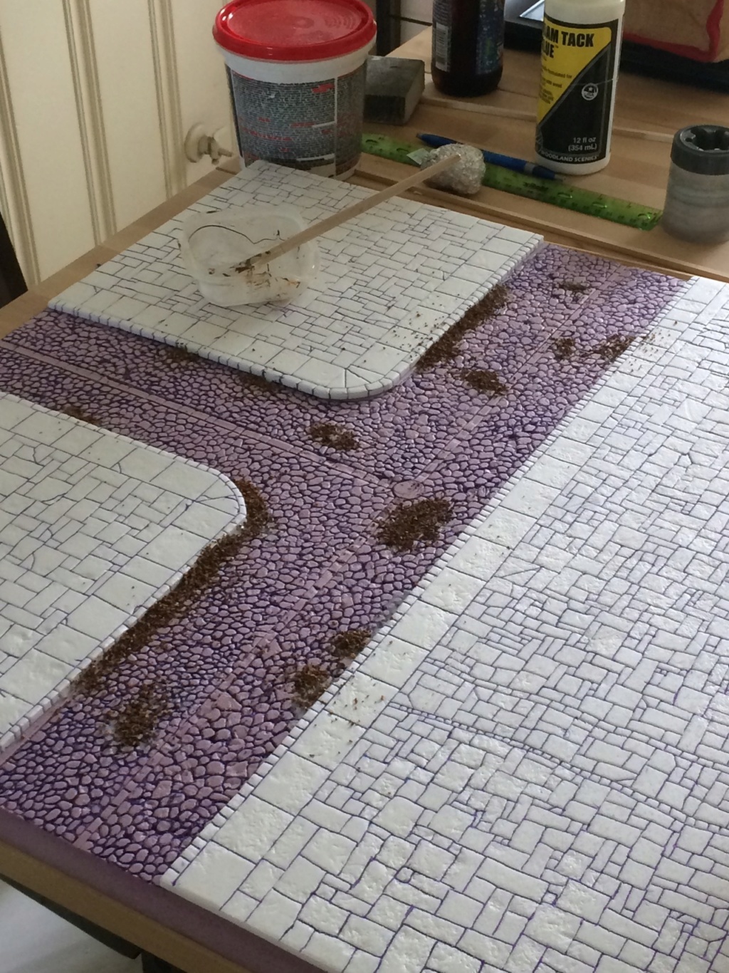

PostSubject: Re: Mordheim Table Time Crunch   Mordheim Table Time Crunch Icon_minitimeWed 17 Apr 2019 - 15:03
Didn't get nearly as much done last night as I wanted to due to a DnD session gone late, but here's the finished product:
Mordheim Table Time Crunch Tumblr18
Mordheim Table Time Crunch Tumblr17
Mordheim Table Time Crunch Tumblr16
I bevelled and weathered the edges of all of the sidewalk pavers to provide a more time-worn effect using the dull edge of my pencil as well.

Additionally, I did this to the other two tiles and drew the flagstone lines down the 'outer' edges of each so that if the tiles were arranged in such a way that the main 4" road ran into a flagstone area (inexplicably, but hey a street could come to a dead end in a 15th century Germanic town? Stranger things have happened), the dead end would at least show the flagstones and not blank foam.
The fourth tile I plan on having a crater in the street, with a ruptured sewer entrance that will lead to a separate 2x2' tile off-board that will be a catacomb or a sewer system to make life more interesting for those entering the City of the Damned...

Got some outlining done last night - not nearly as much done, but the measuring and cutting took well over an hour. I really wanted the streets to narrow to a 2" section for a bit just to mix things up. I'll get done with the cobblestones tonight.
I'm a bit worried that, if placed adjacent to the open square, the whole ensemble would look almost too circular to the eye.
Mordheim Table Time Crunch Tumblr22
Mordheim Table Time Crunch Tumblr21
I've to glue down this tile onto another 1" section of foam to give it density, and then onto the MDF board. Once that's done, I'll start tearing into it for the broken sewer entrance.
All of the others will be put onto a 1" section of foam as well to keep them all the same height, and then onto MDF bases for stability. That'll have to happen when I get back from Bahrain, though.
