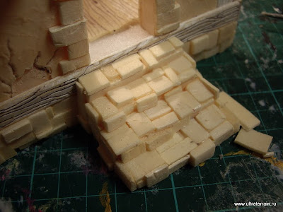

22. Coat the doorstep with "coble stone"
WIP Mordheim house. Again) IMGP6565

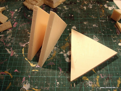

25.Cut three big triangle for the main roof:
WIP Mordheim house. Again) IMGP6568
