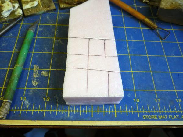

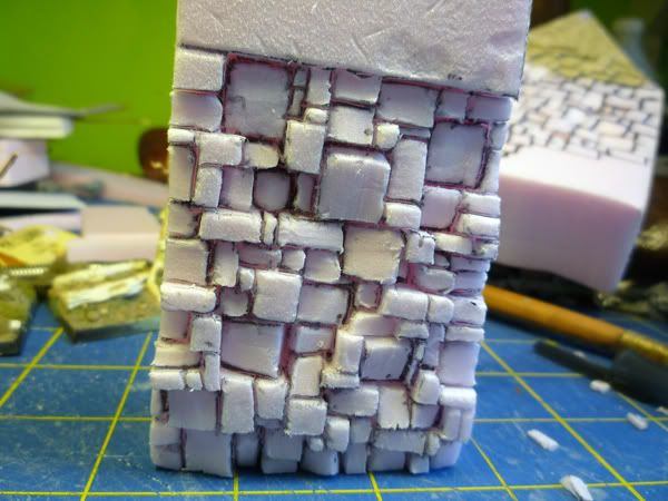

BAM! Tutorial!
So This is the method I use for modeling masonry, sorry for some of the crappy photos.
Chemical Agent's Terrain Cobble1

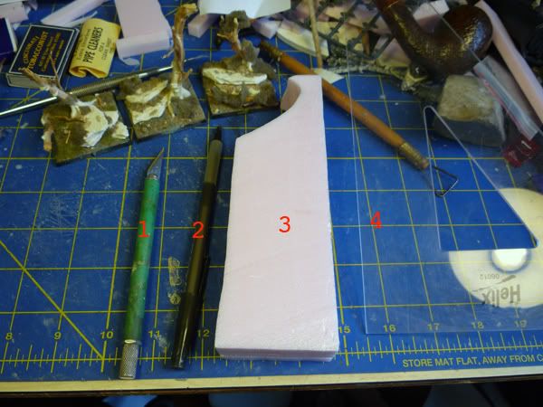

So you will need just four items... well five... maybe.
1. A X-acto knife with a new *SHARP* blade. And if you are doing large areas you will need extra blades. Change the blade when you start feeling resistance when you cut.
2. A ballpoint pen.
3. Foam.
4. A straight edge.
5. Patience.
Chemical Agent's Terrain Cobble2
Ok, start by drawing some guide lines with the straight edge and pen. You don't need to lay out every course of bricks, just a reference point to keep everything mostly straight. Put down as many or as few guides as you feel comfortable with. Really how you lay out your guides will depend on the pattern you wish to model.

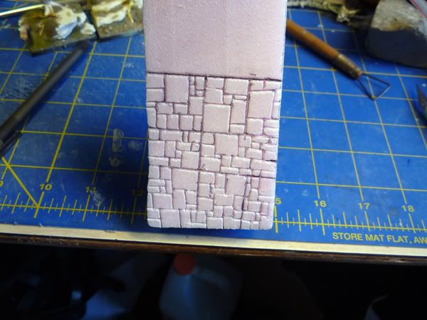

Chemical Agent's Terrain Cobble3

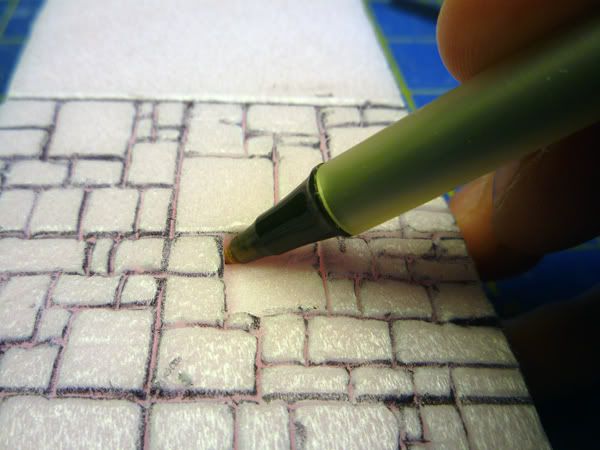

Now take your X-acto and score each brick into the surface of the foam.
Chemical Agent's Terrain Cobble4
Next take the ballpoint pen and run it through each score to widen and define each stone.
*Photo Missing*

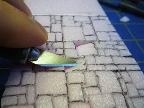

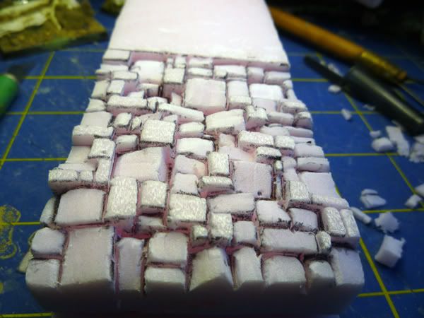

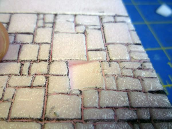

Oops... forgot to save that one... Ok, well now it's time to add some character to your masonry. To make the stones look like they might have shifted, or were not set properly in the first place, you will begin carving into the surface of the foam.

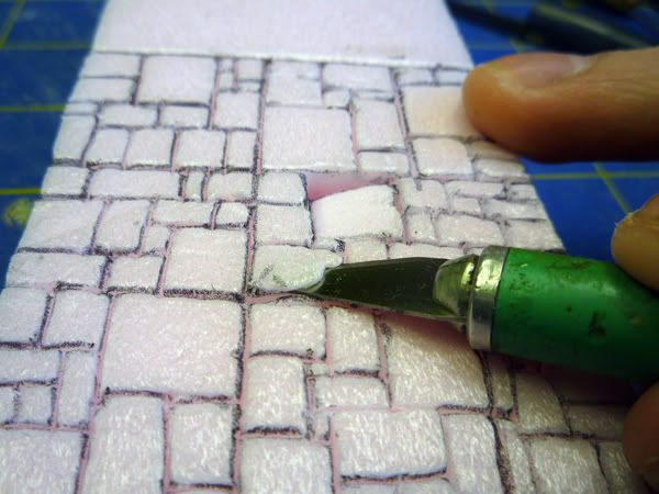

The most simple, let's call it "surface modification", you can make is having the stone shift or drop on one side. To do this simply cut into the surface of your stone at the desired angle with your knife.
Chemical Agent's Terrain Cobble6

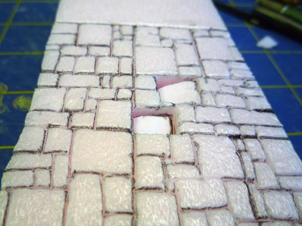

Once the material is removed you will have something like this.
Chemical Agent's Terrain Cobble7

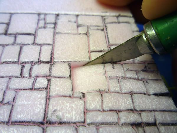

Next take your knife and re-cut around the stone...
Chemical Agent's Terrain Cobble8
...and re-score with the ballpoint pen.
Chemical Agent's Terrain Cobble85
You should have something like the above photo.

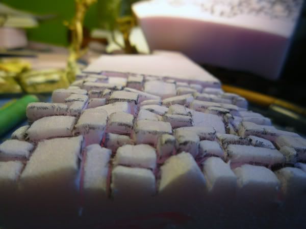

Now to make a stone look like it has dropped down evenly, or was not set correctly you just need to add a few steps.
Chemical Agent's Terrain Cobble9
Start like you did for the "one-side-drop stone" above...
Chemical Agent's Terrain Cobble10
...then cut off the other high side of the stone, forming a high point in the center.
Chemical Agent's Terrain Cobble11
Push down the high point with the other end of your knife.
Chemical Agent's Terrain Cobble12
You will have something like this.
Ok, that is about it really... well kind of...
Chemical Agent's Terrain Cobble13

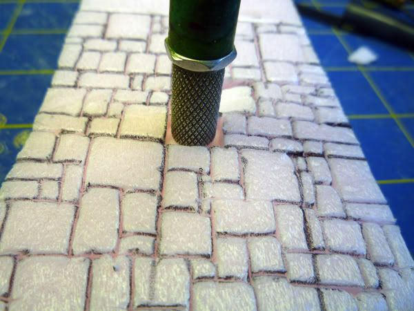

Go around the your surface and pick out stones you want to be low points. Setting your lowest-lows now will help guide the height of the rest of your stones, insuring you don't get carried away and carve everything into a level surface.
Chemical Agent's Terrain Cobble14
Work outward from the lows, picking out stones to be your high and mid points... until you're finished...
That's all there is to it... Just get some scrap pieces of foam to practice on before you go attacking your project.

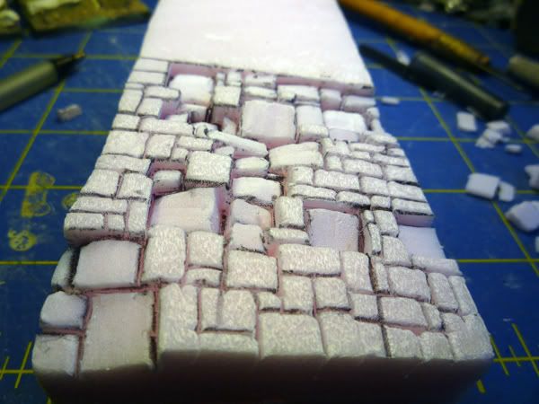

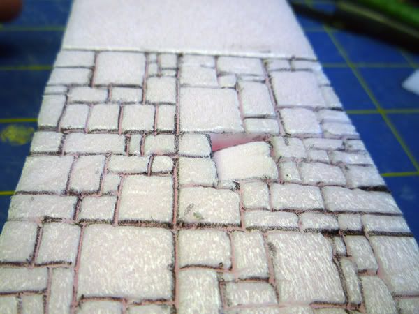

Here are some additional shots to give you some idea of how uneven you can make your masonry.
Chemical Agent's Terrain Cobble15
Chemical Agent's Terrain Cobble16
Hope that made sense... Sorry the whole thing was slapdash, but I hope it helps.

@SeriaMoM: I would show you pictures of a finished Mordheim table if I had one. I just began Mordheim so I have been making a few 'sketches' at the moment. You can see some of my finished work for WFB in the Podhammer link at the end of my first post.
The area that I did for the tutorial was a little over by 2x3.5" and took me around 15 min. The process starts slow, but you get into the swing of it and it goes faster. It would take a few hours to finish a full table, and I'm not saying that this technique is for everyone, but I think the result is worth the time. If you want to cut down the time it would take you could always increase the size of the cobbles/flagstone, or you could leave more stones unaltered... or both.

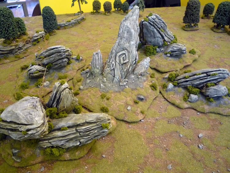

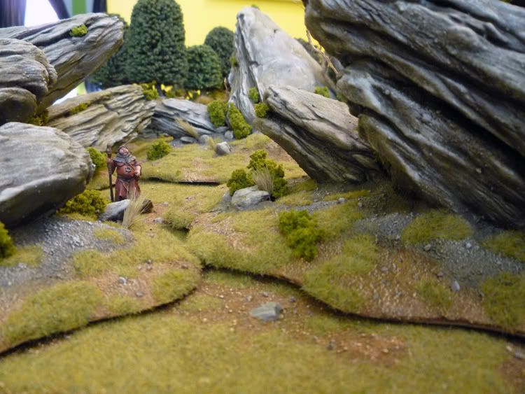

So here is what I've been up to:
Rock formations!
Chemical Agent's Terrain ImpassGroup1
Chemical Agent's Terrain ImpassGroup2
Chemical Agent's Terrain ImpassScale
And here are how they look next to the monolith I built awhile ago:

Love the rocks and the monolith is awesome!
Look really cool together!

Those stones are looking great, how did you do them?

The rock outcroppings are VERY NICELY DONE; they'd enhance any table they're placed on. The Gork or possible Mork Idol looks promising. thumbsup
Too bad about your group lacking taste...erm, losing interest. You have my condolences. Sad
