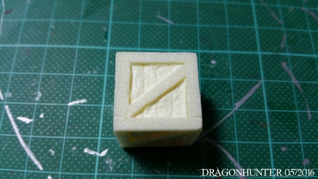

Crate 2
Repeat step 1).
2) With the scalpel cut the planks into the polystyrene.
How to make crates and barrels with polystyrene 0720
3) With the cocktail stick and carving Instrument (for the corners) push the polystyrene in.
How to make crates and barrels with polystyrene 0813
4) Add some more planks on the pushed-in parts with the scalpel.
