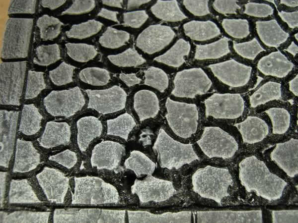

It's me, just showing off my cobblestone. I only managed to take one good close up shot today:
My cobblestone IMG_0087
This is 2" pink insulation foam, textured by pressing a rock into it and drawn on with a soldering iron. The paint job is simply three shades of gray drybrushed over black. I plan on adding brown and green stains to give it some color and break up the monotony of gray.
C&C welcome.

Did you put sand in the cracks or do they naturally look like that?

Was it heated? or did u just use it as a sharp pen to outline the cracks between the cobblestones?

Dedgob: The cracks look like that naturally, after the melting. Also they are a shinny black because of the spray paint i used: Krylon H2o latex. It does not melt foam but is not the matte finish i wanted. After painting the cobblestones i decided i like the shine in the cracks, it looks damp and dirty.
And: The soldering iron was heated up, but i had to keep regulating the temperature by unplugging it. If it got too hot the cracks were too wide and too cool it wouldn't cut at all.
You can see some areas where it got too hot and the lines are thicker and deeper, that was my signal to unplug it. This variation actually adds character i think.
Deaf: Yeah, i had to take breaks from time to time when i got headaches! I moved to a more ventilated place quickly and tied a rag around my face!

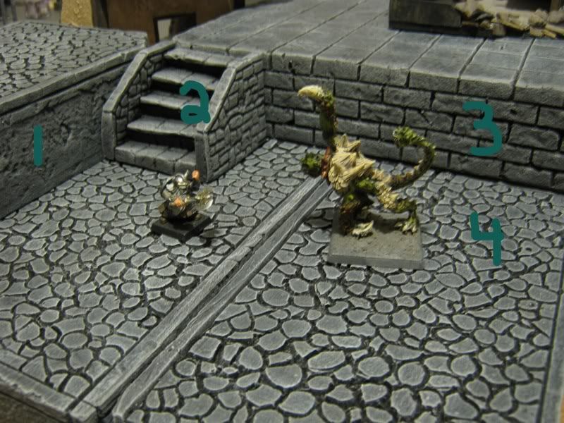

Yes, this is a lot quicker than drawing them on and i really like the depth of the gaps. I find that with a pen i have to repeat the lines to make them deep enough and i always have to be careful about ripping the foam. With my method, it is just one quick pass with the soldering iron.
I have not used the stamp method but i imagine designing the stamp would be a hurdle i never cross.
I'm going to mess around with drawing designs on the foam and tracing with the iron to get fancy cobblestone patterns.
This picture shows the scale better. Also i will explain how each area was textured:
1. A rock was pressed into the foam.
2. The sides of these steps have the traditional drawn on with a pen method.
3. This platform was textured with a rock, and diagonal cuts with a very sharp blade formed the large stones.
4. Once again, textured with a rock, and melted with a soldering iron to form the cobblestones.
My cobblestone IMG_0103

this 2nd pic sure shows just how great these look !

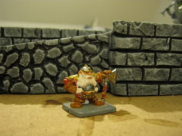

Tools of course are a matter of prefrence for most artists, and sometimes the best tool is not always the one meant for a particular job. In this case I personally LOVE the foamworks tool so I thought I would share.
I dont think my example warrants a new post, and I dont want to spoil the thread with my pictures My cobblestone Icon_redface
Anyway, I dont have any painted examples of cobblestone work I have done with the Foamworks tool, so I did up a quick example for you here http://www.pbase.com/therat/image/117770396/medium I posted it its original size so you can get a VERY up close look if you want. Just click the Original button under the picture (its a large picture). I just used some cheap white packing foam for this example, but it works just as well on pink or blue.
Posts : 778
Join date : 2008-04-11
My cobblestone Empty
PostSubject: Re: My cobblestone   My cobblestone Icon_minitimeFri 2 Oct 2009 - 5:37
That does indeed look very nice! I might have to look into these tools, the sales pitch even mentions cobblestones, awesome! I love your WIP buildings btw.
The latest creation, all painted up. Someday i will add various brown and green washes to these platforms to make them feel more lived in(on).
Also some classic models painted about 10 years ago! Who can name what 3 games they are from?
My cobblestone IMG_0118
My cobblestone IMG_0119
My cobblestone IMG_0120
And here you can see a bit of detail i need to pick out with some paints...
My cobblestone IMG_0125
