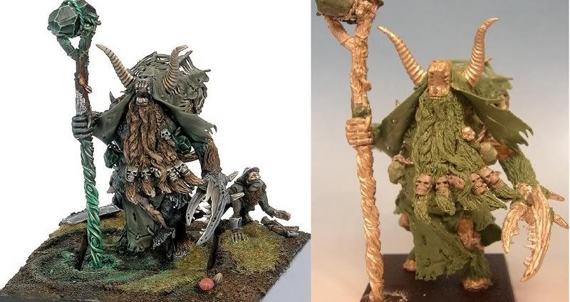

Any part that has to support any kind of weight should first be built and then "skinned" meaning the entire outer surface should be a thin detail layer overtop of your basic forms. This doesnt mean you can skimp much on making the basic forms, however, as if they suck your skin will do little to hide it in most cases.
Just trying to make a shape in one go is the most common mistake for anyone who uses GS as when you go to shape or detail the piece invevitably you distort another part of it. Making a structure for the model is really important as it will keep your shape from distorting and gives you the opportunity to take the time you need to detail your piece without contsantly having to retouch other areas.
You can see here the effects of skinning - I built the model first in basic forms - a large part of it plumbers fast hardening putty (which is VERY strong - but because it dries in 5 mins or less you have to be sure of yourself when applying it) and then skinning it in GS - You cant see hardly any of the underlying putty in the final piece.
If you look here you can see a fully skinned section of a model but only a bulked out shape for the pants (the grey section - again the plumbers putty) - A good strong base gives you infinite possibilities for what to put on top.

PostSubject: Re: Greenstuff Advice   Thu 9 Oct 2008 - 14:16
Holy Moly!!! affraid That model is mind numbing! Well done tkkultist!
Why isn't there an entry in the Gallery for that?
PostSubject: Re: Greenstuff Advice   Thu 9 Oct 2008 - 14:42
Probably because it has nothing to do with Mordheim? Need I really remind you of that, Tom? Wink
It's totally awesome nonetheless, of course!

On a 50(?)mm base? Nah, look more like the Morghur, Master of Skulls special character from Warhammer. In fact, he looks EXACTLY like the illustration from the armybook (page 72).
Bonus points for noting the page #
Yeah I thought the morghur model they made was kindof wussy so I remade mine to match the incredible art piece.... and I used a bloodthirster as the armature. Won me a silver in chicago golden demons a few years ago Very Happy
I keep the small one around in case anyone takes issue with my big version. I have also used him on several occasions as a Doom Bull (minotaur hero model).
As to the belly pic... well thats something special I am still working on.
