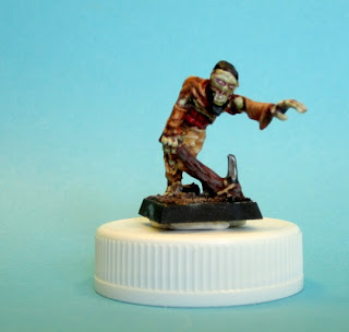

Here is a mini before any varnish, nice matt paintjob.
I start with a thin coat of the Gloss varnish. As when painting your minis, don't just splash the varnish on. Wait 24 hours for it to dry. It gives a wet, glossy finish. Yuck.
After waiting 24 hours I varnish again, now with the matt varnish after shaking the bottle vigorously for a while. Brush the varnish over the whole model and do just one thin coat. The gloss varnish helps you spot any places you've missed. Wait 24 hours for it to dry. If you see some glossy spots, do another layer. You can also leave some parts glossy. I sometimes leave metals, gems, guts etc glossy to add to the effect I want to create.
And there you have it. A varnished miniature with a matt finish that won't cloud your paint job, but protect it against wear and tear.
