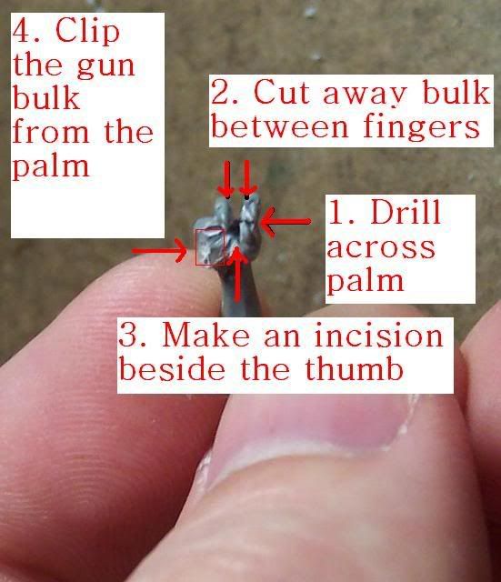

STEP 3: Hands
This step will take practice. If you make a mistake just remember thatís why we have glue.
-The idea is to model a Kroot with free hands.
-Starting with these parts.
-Cut the bulk of the weapons from the hands.
-Using your smallest drill bit, tap a hole across the palm of the hand.
-Then proceed to make the following incisions.
-Try to remove small slivers at a time. It will look rough at first.
-Smooth the edges with your hobby knife as you did with the mold lines. If this is not effective, then continue removing small slivers.
-Repeat these steps for the other hand.
-You will need to drill and pin the second hand to the wrist of the second arm.
-If this intersection is not perfect just add a strip of GS to the wristband.

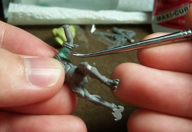

STEP 5: Modeling Features with Green Stuff (GS)
Note: You must repeatedly wet GS or it will be too sticky and unruly to model.

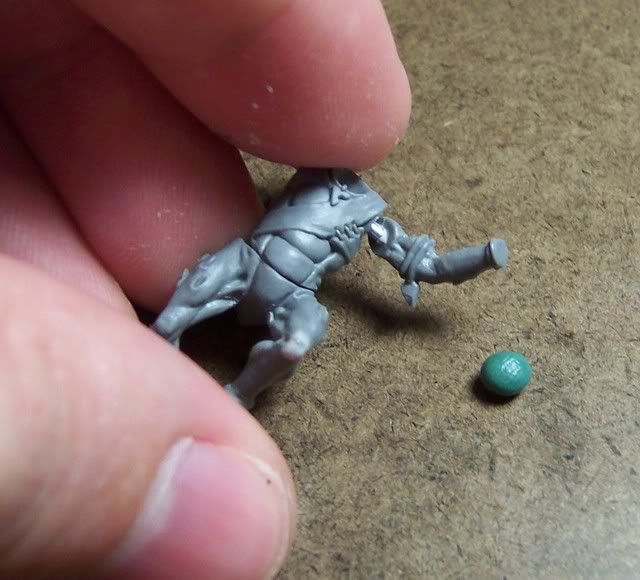

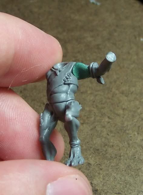

Armpits:
-Roll a ball of GS about the size of the gap in the joint.
-Using a wet finger, press the ball of GS softly into the gap.
-Again using a wet finger, sweep the excess GS around the edges of the joint until it wraps around to the back of the arm.
-Add a dip to the armpit using a sculpting tool.
-Again using a wet finger, sweep the GS at itís edges until it smoothly blends with the models form. If this doesnít work, just add strips of flattened GS where needed to give the impression of musculature.

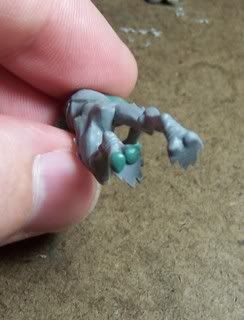

Hands and Feet:
-Roll 4 small balls of GS.
-1 for the palm of each hand and 2 for the sole of the raised foot.
-Gently press the GS balls onto the appropriate bits.

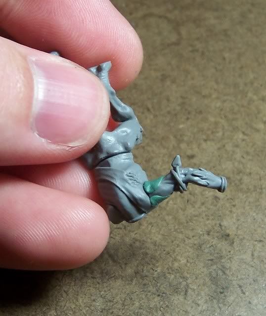

Back and Waist:
-Roll out a long strip of GS and press it firmly into the waist of the model.
-Again using a wet finger sweep the GS until smooth with model.

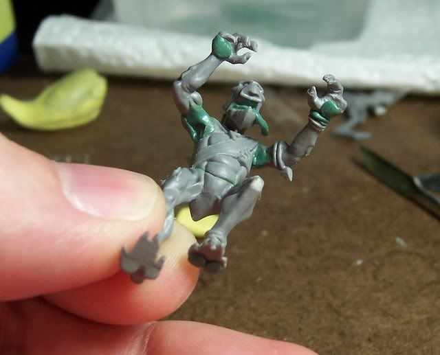

Dynamic Tongue:
-Roll out a long strip of GS and cut of the end.
-The length is entirely up to you.
-Cut most of the plastic tongue out of the models mouth.
-Use your modeling tool to insert the GS tongue.
-This will take plenty of practice.
-Use the modeling tool to reform the GS where it meets the model. You want a smooth transition.
-Press lightly at the back center of the tongue using a wet hobby knife. This will give the tongue a well defined crease.
-Position the tongue using any tool that allows you the greatest ease. It may help to wet it first. Other wise the GS will stick to the tool.
-Here is a bottom view of your work so far:
Note: After all that hard work you donít want your model to roll on its side and smash the GS into some amorphous shape while itís drying. I recommend using Sticky tack to prop up the model parts as the GS hardens.
Here is the final product:
