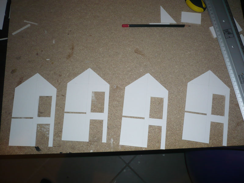

I did it. I have pictures, and an update for you.
Regarding the problems with the available space, I've come up with the following idea: I want to create a series of narrow buildings, which cover almost the whole length of a single terrain tile.
Today, I started building the first of these buildings.
The footprint of the whole thing is roughly 4 x 20 inches, which means that we have around 4 inches of "sidewalk" for our miniatures before they start dropping into the canals (which, basically as The Yak suggested, will get a series of walkways halfway down the wall, adding yet another level to the table).
I managed to finish the foamcore work. Coming up next is cutting the timber framing out of cardboard, placing the wooden floor and "plastering" the walls with glue-soaked toilet paper as well as figuring out how to add a collapsed roof, some stairways and a balcony.
But enough of the talking, let's get to the pictures, shall we?

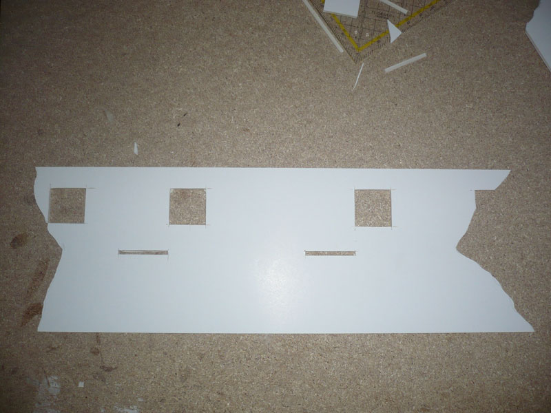

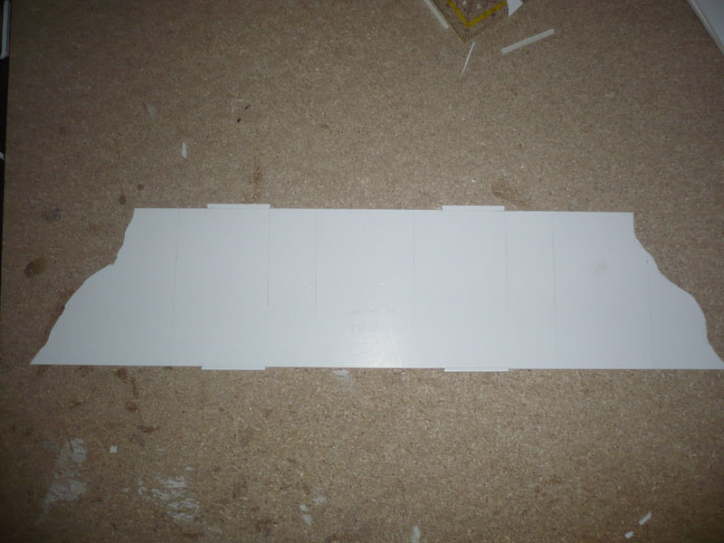

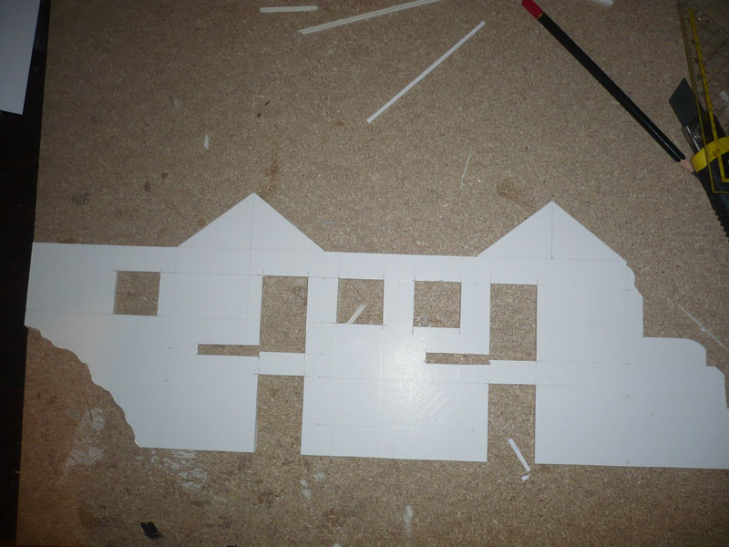

This is the front of the building, with cutouts for the windows, doors and of course, damage. The slots just beside the top doors will become quite important later.
This is the floor, with damaged sections cut out. Notice the pegs? They go into the slots I've mentioned earlier. After taking this picture, I've cut slots for the inner walls as well (see below).
This is the back wall, with upper floor windows and damage cut out.
These are the inner walls. I've actually used just three of them, but I like to keep a spare part at the ready. The horizontal slots slide into matching slots I've cut into the floor board (which, as I've mentioned before, were cut after I took the picture of the floor board).

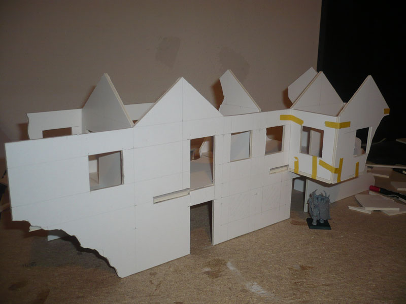

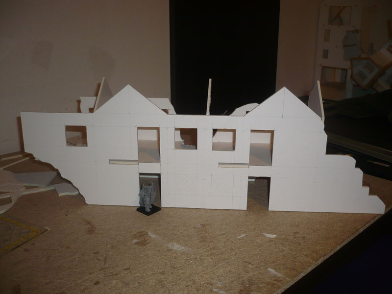

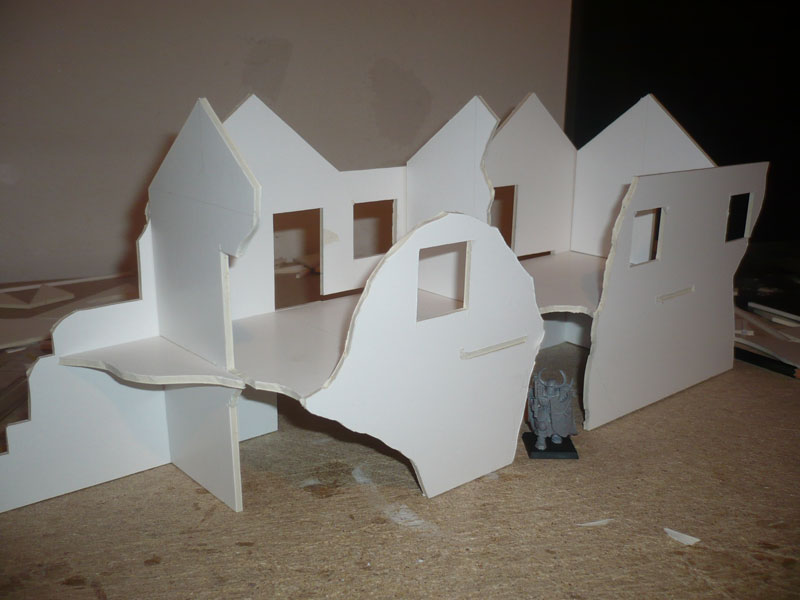

Here's the whole thing. At the moment it's only a dry-fit, since I'm going to do the final assembly after painting the interior. Oh, and please welcome Barry. Barry is going to demonstrate the scale of the whole building for you today.

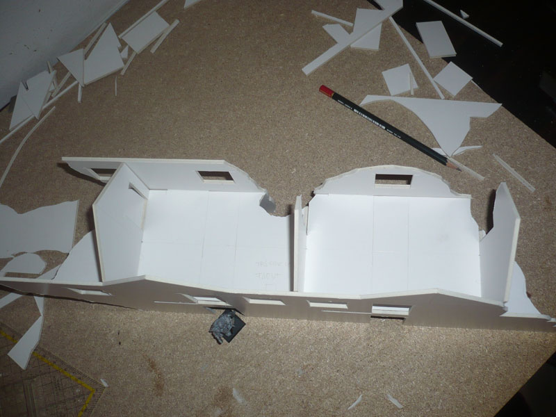

View from above. Please note that I've added some more damage to the rear section of the building.
Rear view. Again, note the additional damage to facilitate moving the miniatures on the bottom floor.

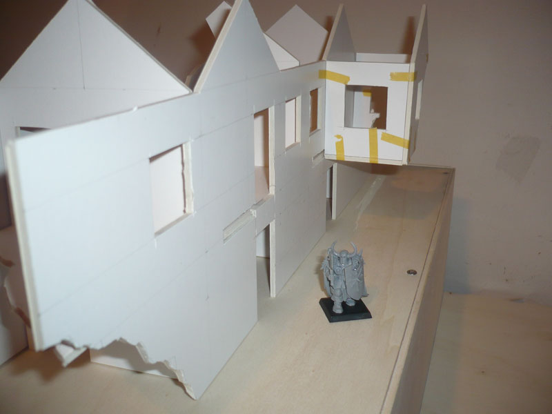

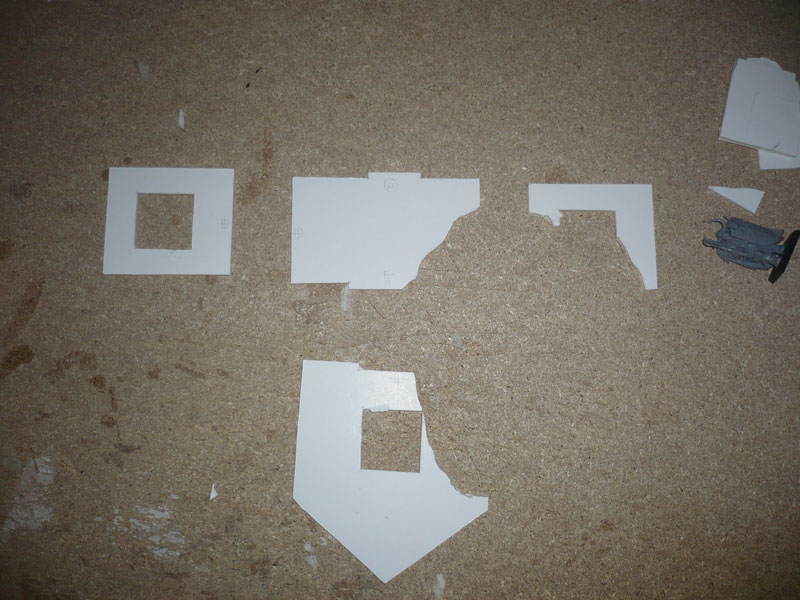

Here are the parts for a partly collapsed jutty. Barry, the lazy git, is taking a nap.
The jutty has been dry-fitted and fixed with masking tape. And Barry's awake again, too!
Barry taking a stroll down the waterfront, showing you how much space there is now (compared to the first pic I've posted with the prototype buildings). If you take into consideration that there is going to be another 2 inches of walkway a little down the wall, I guess you can move down these streets rather easily. And I just love narrow streets and alleys...
That's it for today, folks. And thanks for your patience with me... I actually feel kind of bad, showing up with such an amount of boasting and then not delivering that many results... but we're getting there, I promise. While I was putting this building together, I made notes and took measurements - once I'm finished, I'm giving them to my colleague and he can start building a few more of them, freeing some time for me to start building other stuff.

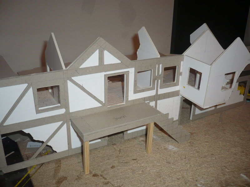

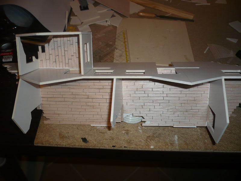

I've engraved the floor boards onto 1mm balsa wood with a pencil (if you try to do it yourself, FOR THE LOVE OF GOD, please be careful, the things snap sooo easily) and glued them to the piece of foamcore I cut out for the top floor. Then I also glued the interior walls into their designated slots and glued the whole thing to the building's front. Here's what it looked like then.

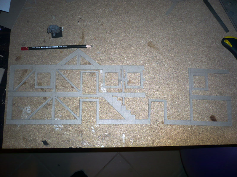

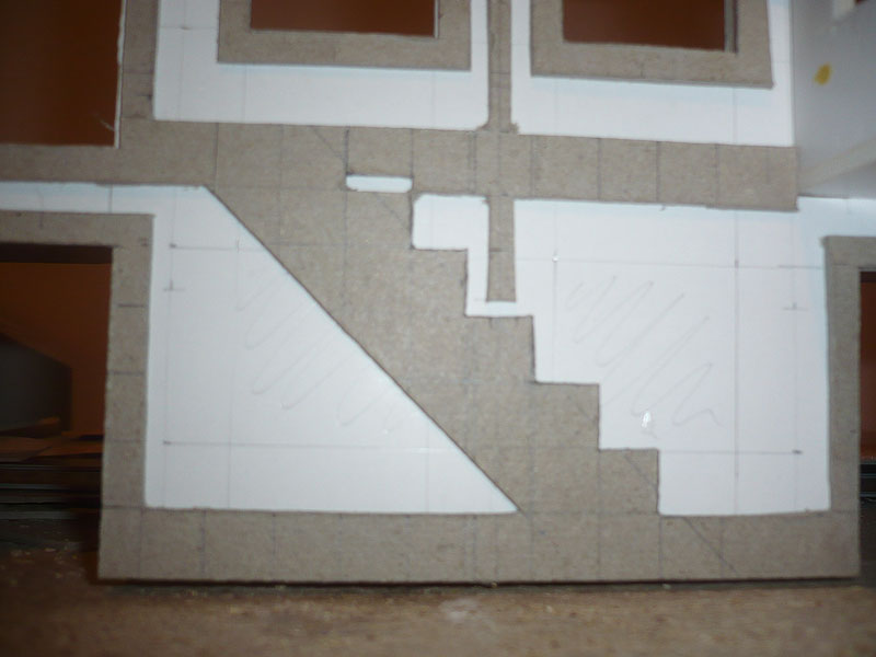

Then I've spent some time cutting out the front's timber framing from a 1.7mm sheet of cardboard. I actually cut the whole thing in one single piece - no extra pieces, just one single piece. To pass the time cutting the damn thing, I regulary cursed like a drunk soldier on shore leave - 1.7mm is pretty damn solid, I tell you - but it provides great definition to the surface. Here's the piece...
After that, I glued the timber frame to the front of the building. Because I wanted to add a balcony with a staircase above the left door, I cut a stair template into the timberwork as well. I then constructed the rest of the balcony out of 1.7mm cardboard and two pieces of 5x5mm pine bars. Here's the whole thing dry-fitted (notice the jutty, also dry-fitted).
Please notice that I haven't cut the damage off the timber framing yet - that's going to be done during the "outer detailing" phase of the build.
Oh, and here's a detail shot of the stair template on the outer wall. The steps will be made out of balsa wood strips.

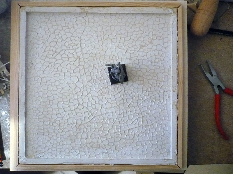

Today I'm very proud to announce that I have made a very big leap forward today (well, tonight, technically) - I've finished the masters for the cobblestone tiles as well as the canal walls, and have successfully made a silicone mold for the cobblestone as well. I'm going to pick up some more silicone today, I think I will be ready for mass-producing the tiles by evening. I'll have to do 21 cobblestone tiles and 21 canal walls, as well as 2 half-sized cobblestone and 4 half-sized canal walls for the terrain tile with the two dead ends.
And, of course, I'll keep true to Internet Rule #32, which says "You must have pictures to prove your statements", so without further talk, here they are:

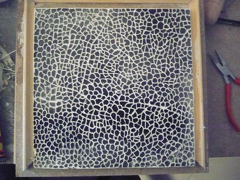

This is the master for the cobblestone plate - I've made a plaster plate, and after it had dried, I sprayed it with black primer to check my engraving. Then I used my Dremel to engrave the cobblestone texture (I've already mentioned the hurting wrist and the tingling fingers? This thing here's is to blame.) To achieve a seamless effect, I've bevelled off the edges of the plate, which means that every time two plates are placed next to each other, the seam is always a recessed area..
Here's the finished silicone mold, already inside a simple support frame to stabilize it while pouring the Keramin. It needs some cleaning up, but I think I'm going to let it dry fully until the evening.

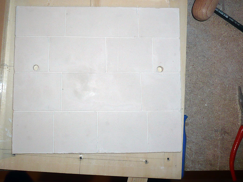

And finally, here's the master plate for the canal walls - pretty straightforward, the canal walls are built out of large stone bricks. Maybe I'm going to add some weathering, but the whole thing's rather fresh out of the frame (about 1 hour).
So you might have one more question: What are these holes for?

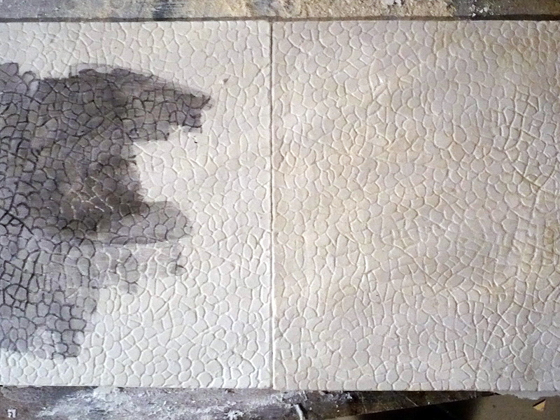

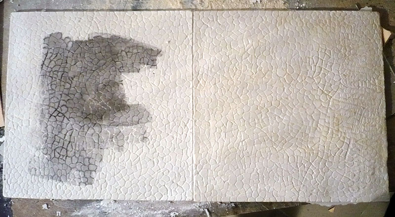

First casting is officially done, folks. I've slapped on some black water color to better illustrate the texture. It came out really, really well, and the second plate is already drying in the mold. Supposed that I don't run out of Keramin tonight, I might be able to cast two or three plates- and once I got more, I'll be able to churn them out at a rate of one per 45 minutes (that's the minimum time the Keramin need to get dry enough to remove it from the mold.
As for the canal wall mold - I think I underdosed the hardener a little. which means it's not fully cured yet (after about 5 hours). Maybe I'll pull it later - I've still got one movie left to watch, so I guess I let it sit for another two hours or so.
EDIT:
Well, I just "un-molded" the second cast. And I grossly overestimated the extent of my Keramin stockpile, so I can't make any more until Monday.
But enough of that talk, here's a shot of both plates side-by-side. Note that the right panel has a completely different facing than the first one (the first's upper right corner is the left's lower left corner - which gives me a bit of flexibility regarding the placement of the tiles on the table.
Please disregard the darker corner to the bottom right - that's just a shadow.
Here's the seam between the two panels again - I'll figure out how to cover it up once I glued the pieces to the actual table.
Now that was it for today, folks. I gotta clean up my workspace- damn Keramin powder, my table looks like Charlie Sheen has visited.
