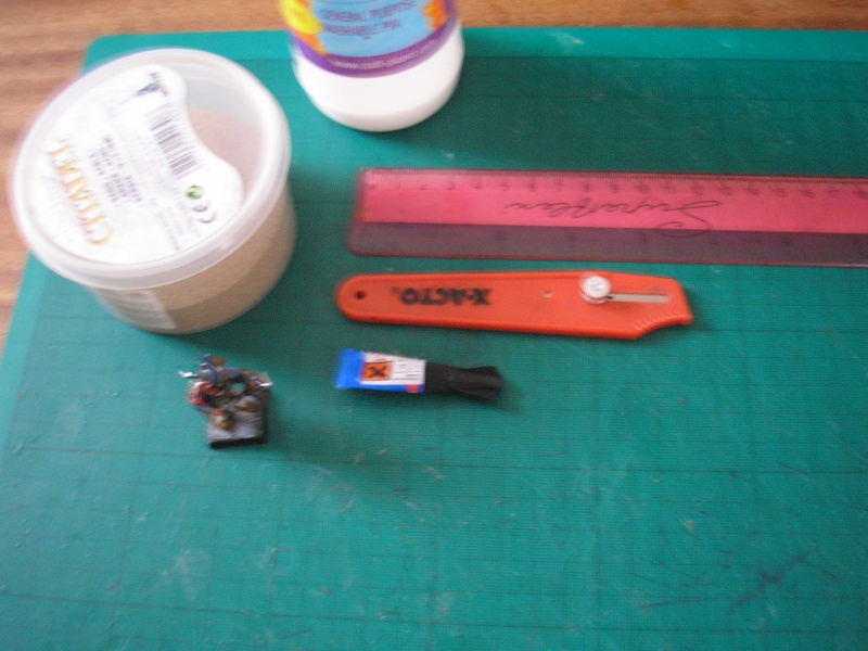

You will need...
*A ruler
*A knife
*PVA glue
*Super glue
*Sand(didn't actually use this...)
And...

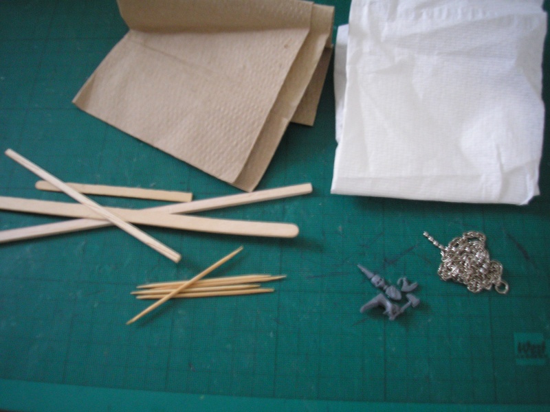

*Balsa wood of varying sizes
*Paper towels of varying kinds
*Plastic bitz
*And any other stuff that looks useful

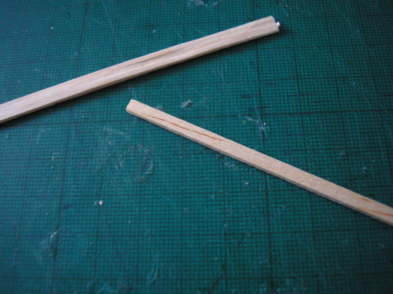

So to begin, mark 2" on a piece of balsa wood...
And cut it...
You will need four of these...wait how did they get into a Skaven symbol? Anyway...
Next take a slightly thinner piece of balsa, and cut it at 2", yuo will need two of these.

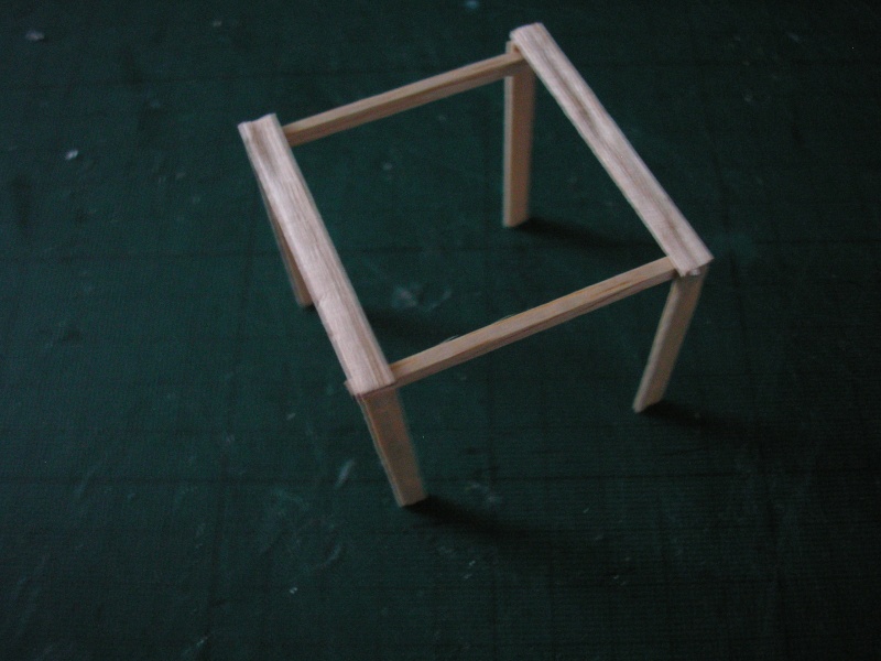

Take these two pieces and glue them to the very edge of the thicker pieces, like so...
again two are needed...
Take the balsa wood used for the main supports, and make two 2" pieces...
And glue them on top of the the supports to make this...
Next get the paper towels, and start to map out were you need to cut...
Until it looks like this... (sorry, I had to turn a light on. It got to dark)
Then get some Pva and put it in the corners of the top, and place the frame in...
And glue the sides...

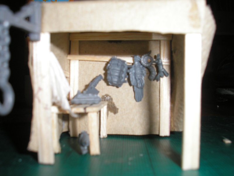

when you come back gets some ineresting bitz to detal it, or you could just leave it plain...
(I made mine into a butchers)
And the finished result...

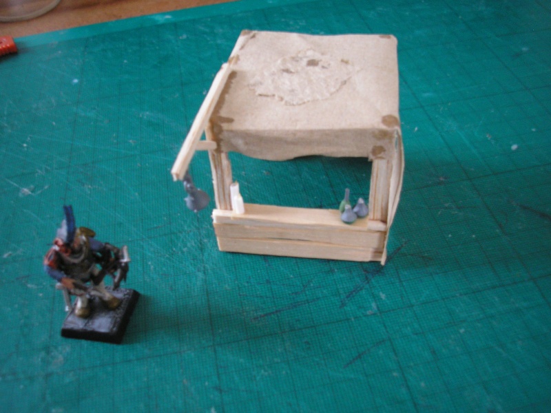

If you want it to have a counter simply add two planks of balsa and one on top to act a s a counter
And there you go, a finished market stall. just needs a paint job cheers
(this is my first time making a tutorial, so let me know how I did Smile)
EDIT: here's some pictures of the two together Smile
