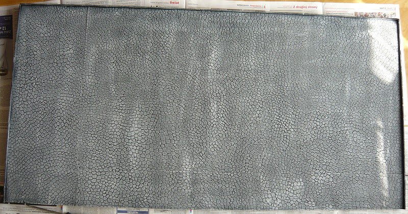

14. When the black paint dried I drybrushed the cobblestones with several layers of grey, starting with darker tones and finishing with almost whitish (though there were about 3-4 layers I've got only one photo to post it below).
15. The final effect (white splashes on the right side are only light reflexes from the nearby window - don't worry, it isn't white paint which accidentally poured down on the board Wink):

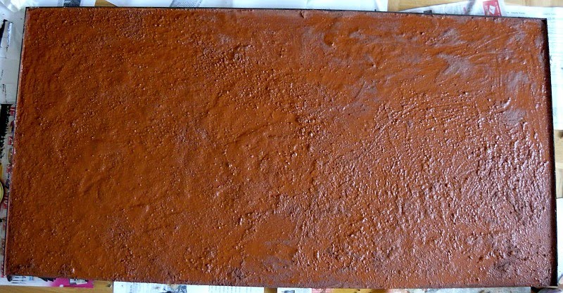

16. Then I came back to the wilderness side and undercoated it with brown paint mixed with PVA glue.
17. I brightened it then with lighter tones of brown.

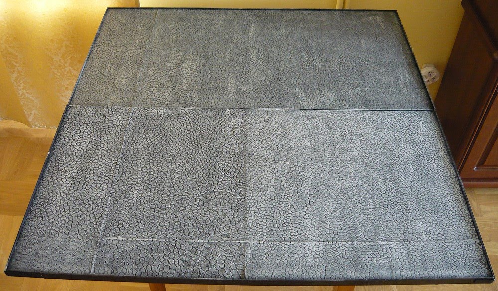

The finished wargame board - enjoy Smile:
