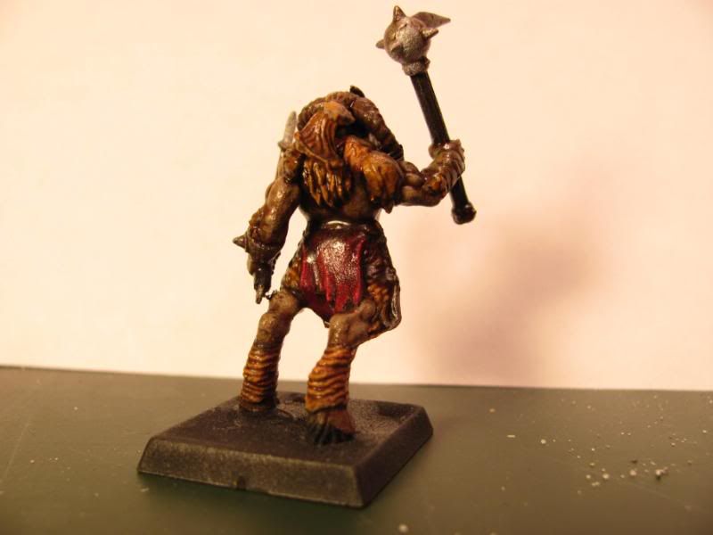

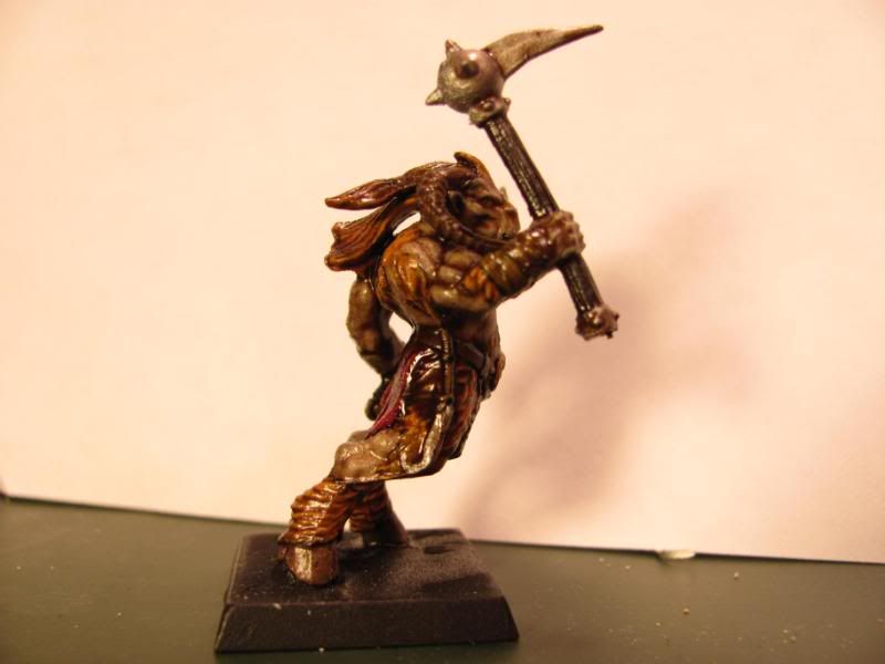

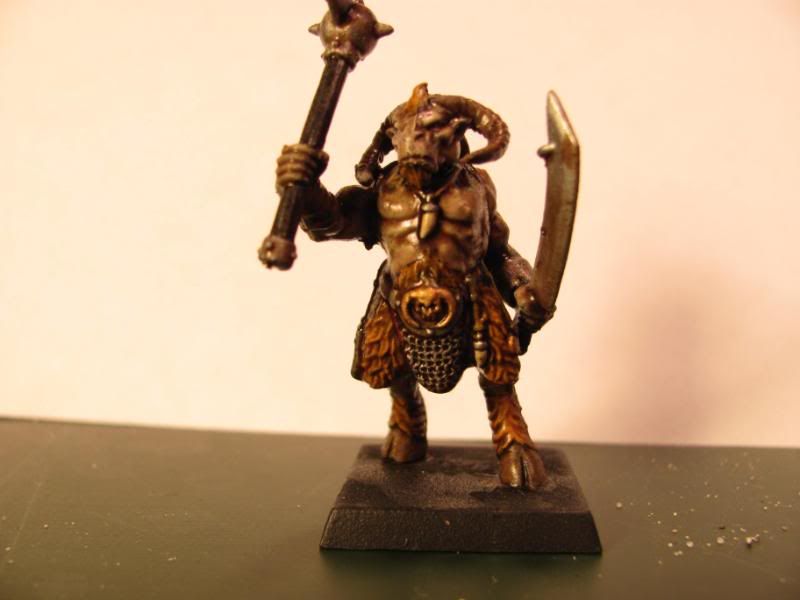

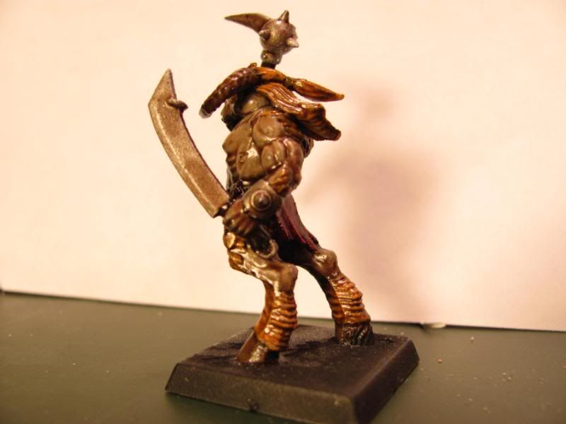

Well, here are a few pics of the test model. Sort of a "blah" palette but the colors aren't really the issue right now ... This model took me less than 45 min to paint up and brush w/ a MinWax stain and varnish combo that I found in the basement that the previous home owners had left. There's quite a bit of shine. I used a little bit of the GW matte varnish to reduce some of it, but I guess it needs a better coat. Either that or a few lightly drybrushed highlights could do the trick as well.
The stain pooled a bit much on the top of the red where the loin cloth meets the waist on the back of the model so I'll have to give the spin method a try or keep a closer watch w/ a brush while the model sits. Though, I do like how the metal parts of the weapon turned out looking a bit rusty.
Over all, I think it's a nice fast way to get a table-top quality force ready that actually looks somewhat decent.

It may take a little practice (as pretty much everything) but you're in your way to it.
This beastman don't look bad at all.
With just a little more care and once you get the hang of tinted varnish, I'm sure you're going to have a suitable battleforce in no time.
KEEP THE GOOD WORK.

Overall I think the model looks pretty good.
I do however agree that its much to shiny. The dull coat I use is a brush-on - not spray and it works. Most sprays are satin not matt (even GWs).
Also - don't forget to let the model dry completely (24 hours) before you add the dull coat.
Other than that keep it up, and please post more pics.

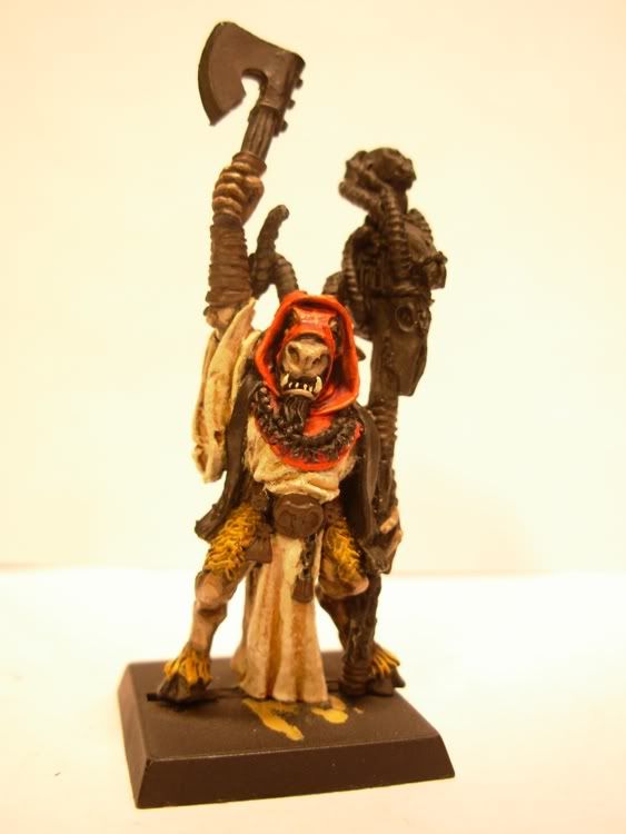

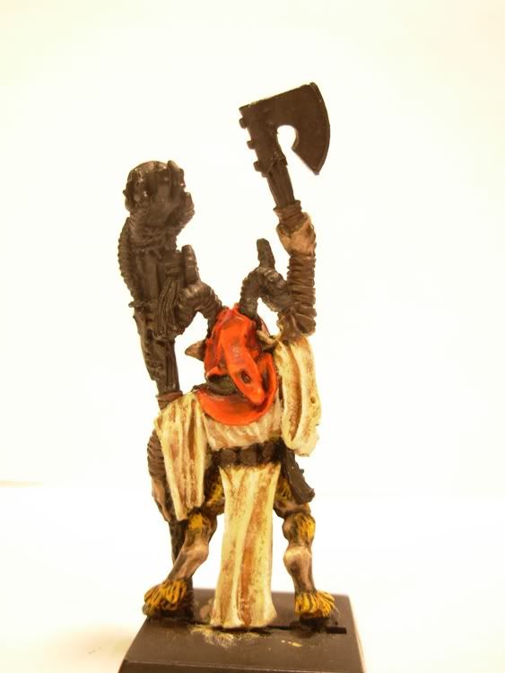

I know I had originally started this as a thread regarding the use of the dipping method. Why dip? To get things painted up in a decent amount of time. Just to show how slow of a painter I am otherwise, here's the shaman from my Beastmen that I've been just painting.
Using the "dip" method - heretical?? Shaman1
Using the "dip" method - heretical?? Shaman2
So:
Gor - 45 min TOTAL
Shaman - been working on it since I finished up w/ the gor. It took me as long just to do the fur sections on the shaman by just painting as it did to do the gor from start to finish. Obviously I've not just sat down for a couple hours straight and painted, but, the time I've got in so far I could have probably done up 3 or 4 more gors using the dip method.
I know the painted mini looks better than the dipped mini...I just need to find some sort of middle ground. Though, I'm so picky when it comes to actually painting a model that I seriously doubt that will ever happen.

There IS quite a difference in the quality of the paint job. Probably the best solution is do both; i.e., dip the minis to get them ready for gaming, then go back & do additional highlighting & detail work to bring them up to the standard of the Shaman...VERY NICE job on the Shaman BTW. Using the "dip" method - heretical?? Fresse

Sad thing Deaf is: Although possible, it's a bit difficult to paint over varnish.
May the answer is the other way around; paint the minis with basic colors, HIGHLIGHT the upper parts, add details, and THEN dip the miniature.
As always, only trial will show the best method for you.
But if all you want are "tabletop quality" miniatures, I think the first beastman fill the bill perfectly.
Oh! and that Shaman looks very good to me!
