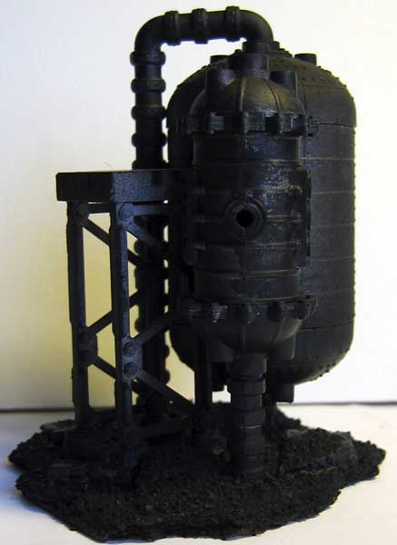

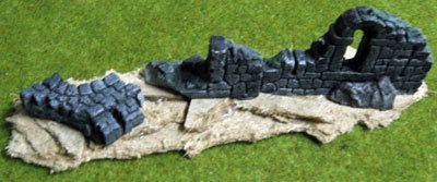

I prefer Masonite for my terrain bases. It does warp a little bit if you use large bits of it, but not to such a degree that it's disruptive to the game. It's sturdy, fairly heavy yet easily workable. I use the Necromundicon-inspired technique of breaking it off bit by bith with a wrench or pair of pliers. Here's a raw and undercoated version:
How do you make terrain bases that don't warp? Ful_02
How do you make terrain bases that don't warp? Chemplant-01
Lovely random natural edges, and stands up to any normal gaming punishment with ease.

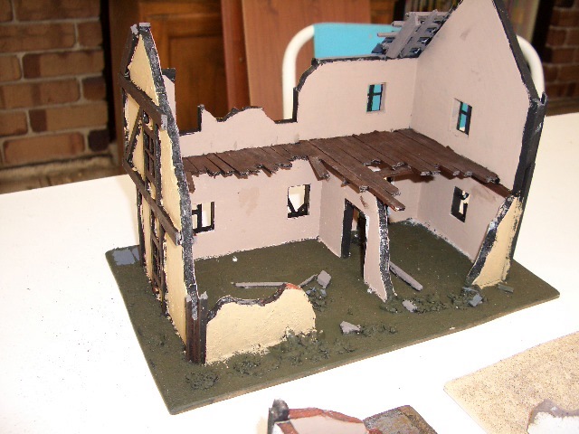

As promised, here are a few shots from my current works-in-progress: all are using MDF bases: once I have time to set up my scroll-saw I'll start experimenting with MDF walls etc.
How do you make terrain bases that don't warp? Imgp3311
How do you make terrain bases that don't warp? Imgp3312
There's still a little bit of work to do on the big building, but the bases have worked out well, and are flat.
